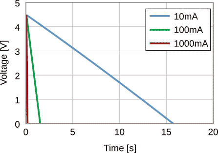

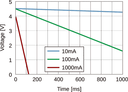

DMHA14R5V353M4ATA0 - Discharge Characteristics DMHA14R5V353M4ATA0 - Discharge Characteristics
Discharge Characteristics Example (DMHA14R5V353M4ATA0, nominal capacity 35 mF).
