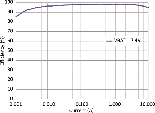

Power Converter - Efficiency
Power Converter – Efficiency.
