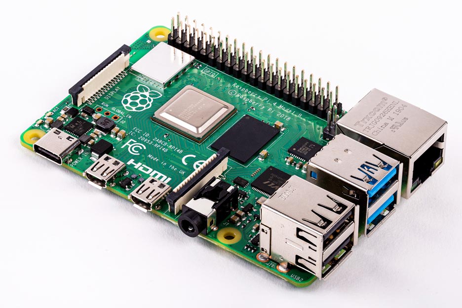

This is the first time Raspberry Pi offers a choice in memory size, including 1 GB RAM for $35, 2 GB RAM for $45 and 4 GB RAM for $55. And this latest Raspberry Pi has been designed to be compatible with existing HATs and other accessories.

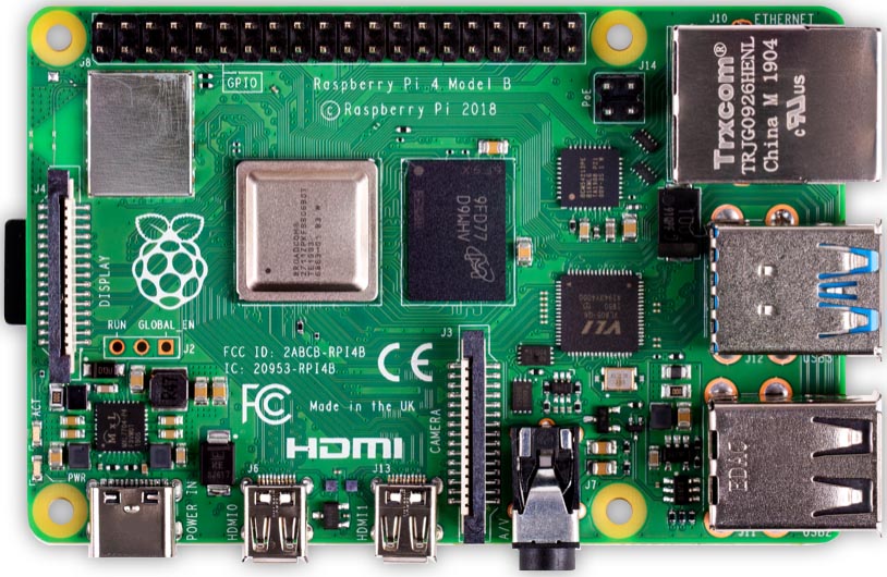

Raspberry Pi 4 has moved from USB micro-B to USB-C for a power connector. This supports an extra 500 mA of current, ensuring users have a full 1.2 A for downstream USB devices, even under heavy CPU load.
To accommodate dual display output within the existing board footprint, the type-A (full-size) HDMI connector has been replaced with a pair of type-D (micro) HDMI connectors.
The Gigabit Ethernet MagJack has moved to the top right of the board, from the bottom right, greatly simplifying PCB routing. The 4-pin Power-over-Ethernet (PoE) connector remains in the same location, so Raspberry Pi 4 remains compatible with the PoE HAT.
The Ethernet controller on the main SoC is connected to an external Broadcom PHY over a dedicated RGMII link, providing full throughput. USB is provided via an external VLI controller, connected over a single PCI Express Gen 2 lane, and providing a total of 4 Gbps of bandwidth, shared between the four ports.
All three connectors on the right-hand side of the board overhang the edge by an additional millimeter, with the aim of simplifying case design. In all other respects, the connector and mounting hole layout remains the same, ensuring compatibility with existing HATs and other accessories.
