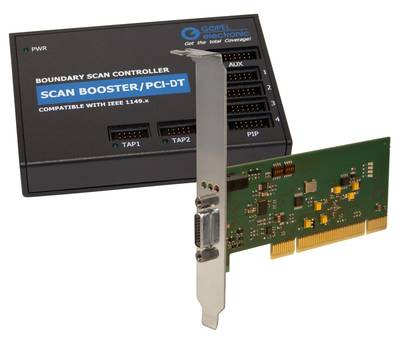

Goepel electronic launched the Scanbooster/PCI-DT, a low cost boundary scan controller compliant with the PCI bus specification. The part supports JTAG/boundary scan tests, VarioTAP emulation tests, in-system programming (ISP) for PLD and FPGA, as well as in-system programming for flash serial EEPROM devices of moderate size.
Low cost boundary scan controller for the PCI bus
“Scanbooster/PCI-DT was developed to open the PCI bus’ high performance for low cost Boundary Scan applications with signal critical distances”, says Bettina Richter, Goepel electronic’s corporate marketing manager.
The boundary scan controller consists of a PCI plug-in card coupled with an external TAP transceiver unit, whereby distances can be up to four meters. It features two separate Test Access Ports (TAPs) and supports a programmable TCK frequency up to 16 MHz.
Exchangeable TAP Interface Cards (TIC) make the controller flexible and future-proofed. Test bus parameters such as output and input voltage as well as output and input impedance can be programmed independently for both TAPs.
As additional resources, the controller provides 32 voltage-level-programmable, dynamic Parallel I/O, two ADC/DAC channels, external trigger signals, and three static I/O. Thus, it is ready to be deployed for extended test and PLD/Flash programming operations.
Programs developed for the controller are cross-compatible with any controller of the Scanbooster series or the innovative Scanflex boundary scan platform.
