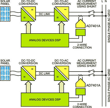

Figure 2 shows a pair of solar PV inverters like those described in the introduction. Tied to a power bus that is connected to the grid, they are independently measured and switched. Each solar panel is connected to its dc-to-dc step-up circuit, then to a dc-to-ac inverter. (When used, a storage battery would be connected and switched, under control. Any discussion of storage is omitted to simplify this explanation).
Solar PV system example
Figure 2. Solar PV system example.
A digital signal processor (DSP) controls the process. The AD7401A isolated ADC measures ac output current of the order of 25 A. Solar PV inverter systems may or may not have an isolation transformer at the output. If the transformer is omitted to save cost, the solar PV inverter must also measure any dc component of the output current. The presence and magnitude of this “dc injection” is a critical matter, as too much dc current injected onto the grid may saturate any transformers in its path. This value must be limited to the low milliampere range, so the AD7401A must measure both ac current in the 25-A range and low-millliampere dc.

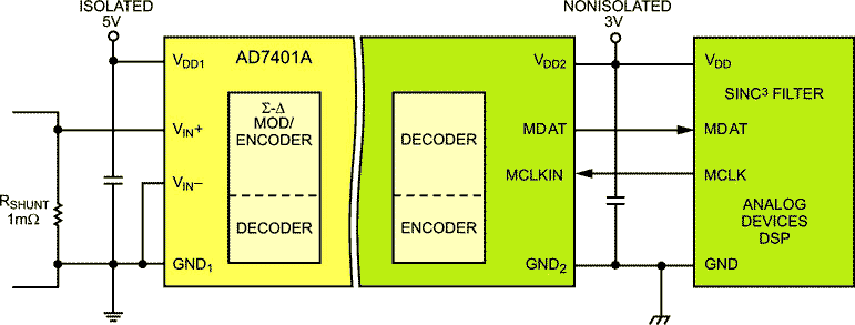

The AD7401A iCoupler – isolated Σ-∆-modulator ADC, continuously samples the voltage across the current shunt, as shown in Figure 3. Its output is a 1-bit data stream, which is isolated and fed directly into a DSP. The density of ones in the output stream represents the input amplitude, which can be reconstructed with a digital filter implemented in the DSP.
Isolation is required within solar PV inverter systems, primarily because of the high voltages appearing on an ac grid. The ac voltage, even in single-phase systems, can peak at 380 V. The AD7401A’s isolation can handle bipolar voltage up to 561 V, which makes it highly suitable for this application. A key advantage to using the AD7401A is that its small package allows the ADC to be located very close to the actual ac current shunt, whereas the DSP may be some distance away – or even on another board in the system. This improves the accuracy and reliability of data in the measurement and control system. The ADC output data is sent to the DSP serially via a single-bit stream at a 16-MHz clock rate, supplied by the DSP.

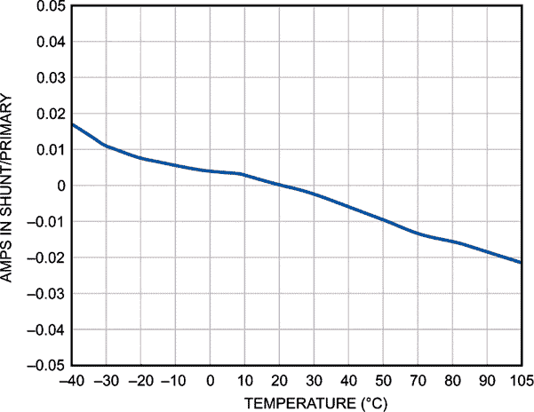

This system can measure ac currents up to 25 A and dc injection in the low milliampere range. Figure 4 illustrates offset and linearity errors of the AD7401A SMS solar module. This shows the offset current in the shunt at ±20 mA over temperature. Thus, the module can measure dc injection down to 20 mA, as well as 25-A (or greater) system currents using a single solution. Current transformers and other types of measurement systems might require two devices, one for large ac currents (25-A range) and one for small dc currents (300-mA range). This is one example of how iCoupler technology can provide smart grid integration with cost savings.

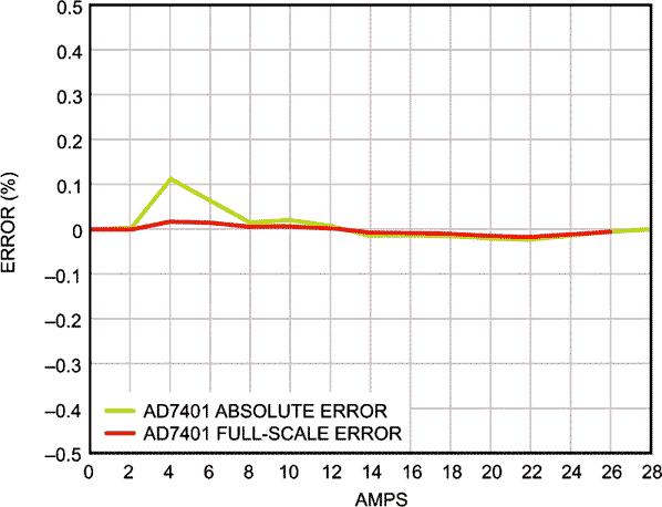

Although full-scale accuracy is extremely good, the real test of a device’s linearity is its absolute error, especially at low ranges. Absolute error is the error associated with the measurement over its range of values, as opposed to simply the error at full scale. Some current transformers specify their devices as 0.1% full-scale range. While this looks good, it may not tell the full story.
From the data shown in Figure 4, the absolute error of current measurement using the AD7401A is quite low over the entire range, indicating low nonlinearity and reduced harmonic distortion of the waveform from the output of the solar PV inverter. This, in turn, helps reduce harmonic distortion when integrated with the grid, providing another example of how this new technology improves performance.
