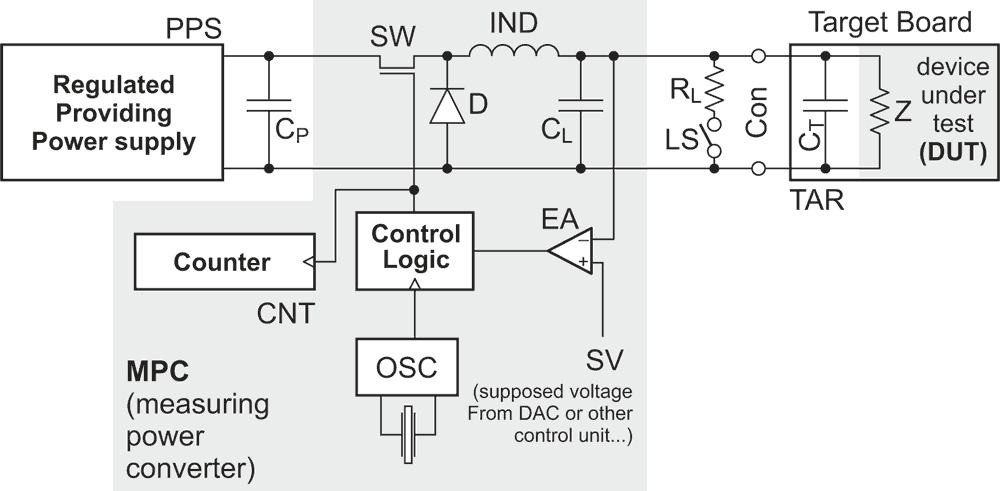

A developer team at Texas Instruments in Freising (in the vicinity of Munich/Germany) found an unconventional solution which operates ‘digitally’ to some extent because the operating energy is not supplied to the load continuously, but in small increments which are subsequently counted. A switching regulator (a buck converter in this case) is another core element which in its most basic implementation consists of a switching transistor (SW), an inductor (IND), a diode (D) and a storage capacitor (CL), as shown in Figure 1. The circuit is powered from the stabilised voltage source PPS whose output voltage is buffered by capacitor CP. The converter’s output powers the external load (i. e. the microcontroller with its widely varying current drain) with an additional capacitor (CT) connected in parallel. If necessary, a constant load (i. e. a known resistor) can additionally be connected using a switch.
Digitising Linear Measurement
Figure 1. Block diagram of a switching regulator used for current measurement.
This variant includes a special trick: The switching regulator is not operated the usual way at a constant frequency with a variable duty cycle. Instead, the on-time is fixed, stabilised by the crystal oscillator OSC. The frequency and the component values were selected such that the energy stored in the inductor during SW’s ontime is small compared to the energy stored in the capacitors CP and CL. In order to monitor the output voltage, the error amplifier EA compares the actual value with the desired value If the voltage is too low, the switching transistor is switched on for the specific fixed interval (one or more periods in the practical implementation) at the next clock edge. At a typical oscillator frequency of 16 MHz, the interval will be 62.5 ns or a multiple thereof.

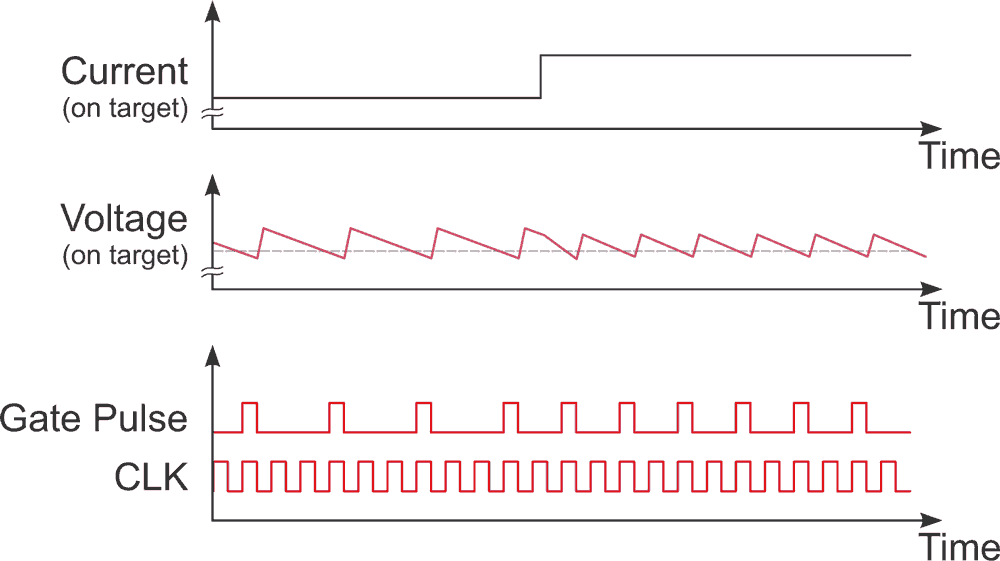

The inductor will then extract some energy from CP and transfer it to CL during the transistor’s off interval. This will only have a very small influence on the voltages at CP and CL. Due to the continuous current flowing into the load from CL, the voltage at CL will decrease until the error amplifier determines that the voltage is too low after a couple of clock pulses. The transistor will then be switched on again for a fixed time, thereby repeating the whole sequence. Therefore, the off time (and the switching frequency) will vary depending on the load. In each cycle, the same amount of energy will be transferred from the input to the output. If more current is drawn, the number of cycles per second will increase accordingly (Figure 2). In other words, the frequency will be proportional to the load current. In order to achieve a linear relationship, the voltage at CL and CP must be constant. This, in turn, is guaranteed by stabilising the source PPS and the stable reference voltage SV. The number of pulses counted by CNT during a specific interval is a measure of the amount of energy (and of the current, if divided by the measurement time and the output voltage).

Figure 2. The circuit’s residual sawtooth-shaped ripple is no issue. The switching frequency rises at a step change from a small current to a high current, resulting in a minor
ripple reduction.
Practical experience has shown that this approach is feasible over several orders of magnitude, featuring high linearity for currents above 100 nA. Although the accuracy becomes worse below this level, this method is still adequate for estimations. Losses resulting from voltage drops at the diode and parasitic capacitances as well as manufacturing tolerances of the components are equal for all pulses, making the measurement accuracy much better than with the PWM approach mentioned at the beginning. The circuit only requires a single initial calibration using the known reference resistor which is connected to the output instead of the microcontroller.
As an additional benefit, higher pulse frequencies caused by increased current drain (which may result from analog sections on the chip) lead to less ripple due to the bypass capacitor.
