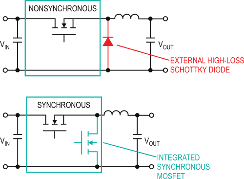

There are trade-offs between them. A nonsynchronous topology is an older design, noted for power loss across the external Schottky diode. This power loss equates to compromised efficiency. A synchronous topology is recommended here because it offers high efficiency and fits in a more compact form factor by integrating an efficient MOSFET. This fundamental difference is illustrated in Figure 1 which compares the structural differences between a nonsynchronous converter and a more integrated synchronous solution.
| Figure 1. | A nonsynchronous DC/DC converter topology (left) uses an external Schottky diode to regulate voltage. The synchronous topology (right) integrates a MOSFET to replace the Schottky diode. |
Think about power efficiency. In recent years, analog IC vendors introduced synchronous DC/DC converters to improve power efficiency lost to nonsynchronous designs with their external Schottky diodes. Now a synchronous converter integrates a low-side power MOSFET to replace the external high-loss Schottky diode. The power dissipation of the low-side MOSFET affects RON while the forward voltage drop across the diode VD determines the power loss of the Schottky diode. If the current level stays the same in both designs, typically the voltage drop across the MOSFET is lower than across the diode, resulting in lower power dissipation with the MOSFET.

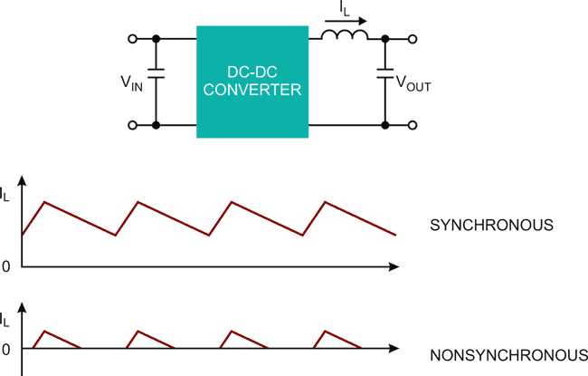

However, there are opinions stating that nonsynchronous buck converters offer higher efficiency at lighter loads and high duty cycles, [2] and it seems that there is not a single converter that can deliver optimal efficiency across light to heavy loads. Are power system designers once again stuck on the proverbial "horns of a dilemma?"
| Figure 2. | Current flows in synchronous converters vs. nonsynchronous converters. |
To answer that question, consider the main impetus for the high-efficiency performance of nonsynchronous converters at light loads. The inductor current flows in only one direction in nonsynchronous converters and never goes negative; the current flows in both directions in synchronous converters, and this is a disadvantage (Figure 2).
