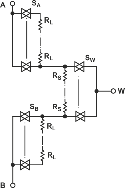

Figure 1. Digital potentiometer – internal structure.

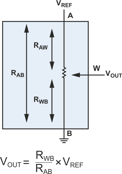

A digital potentiometer can be used to emulate a simple low resolution digital-to-analog converter (DAC). Figure 2 shows this setup, as well as some terminology that is frequently seen. The end to end resistance is defined as RAB, the resistance between terminals A and B. RAW and RWB refer to the resistance between the wiper and the terminal. The transfer function is also noted in Figure 2.
Digital Potentiometers vs. Mechanical Potentiometers: Important Design Considerations to Maximize System Performance
Figure 2. Digital potentiometer as a low resolution DAC.
For this setup, there are three key parameters to note while choosing a digital potentiometer. The voltage supply range, the digital potentiometer resolution, and linearity.
Voltage supply1 and resolution2 are important considerations as these specifications cover the range of inputs the digital potentiometer can pass and number of distinct resistance levels that can be achieved. The linearity of a digital potentiometer is specified in a similar manner to DACs using INL (integral nonlinearity) and DNL (digital nonlinearity). INL refers to the maximum deviation of a real digital potentiometer from an ideal straight line drawn from zero scale to full scale. DNL refers to the difference between the output and ideal transfer function for successive codes.

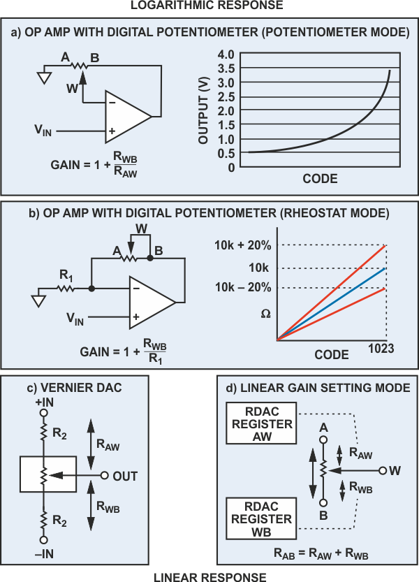

Digital potentiometers are very useful in varying the gain of an op amp. The gain ratio of Rb/Ra can be set and varied precisely using the digital potentiometer. Applications that utilize gain control include volume control, sensor calibration, and contrast/brightness in LCD screens. However, there are a number of digital potentiometer characteristics that must be considered during configuration.
When a digital potentiometer is used in potentiometer mode, one must be aware of the transfer function of the digital potentiometer as the resistance increases from zero scale to full scale. As the resistance between RAW increases, RBW decreases, this creates a logarithmic transfer function. Logarithmic transfer functions are more suited to the human ear and eye response (Figure 3(a)).
Figure 3. Potentiometer configurations.
If the application requires a linear response, the digital potentiometer can be linearized either by using the digital potentiometer in rheostat mode (Figure 3(b)), a Vernier DAC configuration (Figure 3(c)), or through the linear gain setting mode, a feature exclusive to members of the ADI digiPOT+ family such as the AD5144 (Figure 3(d)).
Rheostat Mode with a Discrete Resistor
Using the digital potentiometer in rheostat mode and placing it in series with a discrete resistor, the output can be linearized (Figure 3(b)). This is a simple design, however, there are design considerations that need to be taken into account to maintain system accuracy.
Both mechanical and digital potentiometers have a tolerance on the resistance for different reasons. For mechanical potentiometers, the tolerance can vary due to the difficulty of achieving repeatable values. For digital potentiometers, there is tolerance due to the manufacturing process but it has values that are far more repeatable compared to a mechanical potentiometer.
A discrete surface mount resistor may have an offset as small as 1%, but some digital potentiometers can have an end to end resistance tolerance of up to 20%. It is this mismatch that can lead to loss in resolution and can be a significant problem, particularly in open loop applications where monitoring is not practical to compensate for the error. Where monitoring is possible, the built-in flexibility of digital potentiometers allows a simple calibration routine to adjust the wiper position of the digital potentiometer and adjust for any offsets.
Analog Devices portfolio of digital potentiometers are specified with varying tolerances of 20% down to 1% to match the most stringent precision and accuracy needs. Some digital potentiometers, such as the AD5258/AD5259, factory test the error tolerance and store the results in user accessible memory to allow resistor matching at production.
Linear Gain Setting Mode
The final method is the linear gain setting mode exclusive to ADI’s digiPOT+ portfolio. Figure 3(d) shows how the patented architecture implemented allows for independent programming of the value for each string RAW and RWB. Using this mode allows for a linear output by fixing the output of one string (RWB) and setting the other string (RAW). This operation is similar to using the rheostat mode digital potentiometer with a discrete resistor. However, the overall tolerance error is less than 1% without any extra parallel or series resistance combination.

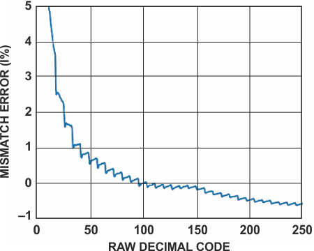

Figure 4. 10k resistance match error.
This is due to the error in the resistances, as it is common in both resistor string arrays and can be disregarded. Figure 4 shows the mismatch error between the two resistances is small at higher codes. The mismatching does increase above ±1% at codes lower than quarter scale, but this is due to the error added by the effect of the internal CMOS switches resistance which cannot be ignored.
