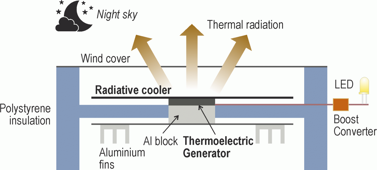

The harvesting technology leverages the difference in temperatures and captures some of the heat from the surrounding air that would otherwise rise into the sky. It’s then converted into electricity via an arrangement that’s simple, low cost (~$30), reliable, and maintenance-free (see figure 2).

Figure 2. The simplicity of an arrangement that uses radiative sky cooling for energy harvesting is apparent
in the block diagram (a). The unit is set up for “field” (actually rooftop) tests (b). (Source: UCLA)
It consists of a polystyrene enclosure about one meter across, covered in aluminized Mylar to minimize thermal radiation and protected by an infrared-transparent wind cover, placed on a table one meter above roof level. It drew heat from the surrounding air and released it into the night sky through a simple black emitter, which was an aluminum disk painted black on one side to face the sky. The researchers used the disk to radiate the heat being given off by the surrounding air.
A thermoelectric generator (TEG) mounted on an aluminum block with additional heat sinks under the disk for cooling converted that heat into electricity. The entire harvesting device was constructed from off-the-shelf standard items available at hardware stores or electronic-component distributors.
