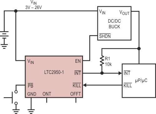

Typical Application with One External Component.
Figure 1. Typical Application with One External Component.

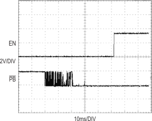

The circuit in Figure 1 provides manual control of the shutdown pin of a DC/DC converter. To turn on the converter, the LTC2950 first de-bounces the pushbutton input and then releases the low leakage enable (EN) output. The turn on de-bounce time defaults to 32 ms and is extendable by placing an optional capacitor on the ONT pin. This allows the handheld designer to adjust the length of time the user must hold down the pushbutton before turning on power to the device. The timing of Figure 2 illustrates performance with a noisy \PB pin.
Turn On De-Bounce Timing.
Figure 2. Turn On De-Bounce Timing.
Protect Against Faults at Power Up
The LTC2950 starts a 512 ms blanking timer after it enables the DC/DC converter. If the \KILL input is not driven high within this time period, the part automatically shuts off the converter. This failsafe feature prevents the user from turning on the handheld device when there is a faulty power converter or an unresponsive microprocessor.Controlled Power Down

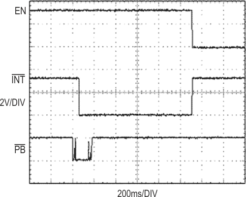

To turn off the handheld device, the LTC2950 first de-bounces the pushbutton input and then asserts the interrupt output (see Figure 3). The turn off de-bounce time defaults to 32 ms and is extendable by placing an optional capacitor on the OFFT pin.
Turn Off De-Bounce Timing.
Figure 3. Turn Off De-Bounce Timing.
The LTC2950 then starts an internal 1024 ms blanking timer that allows the microprocessor to perform its power down housekeeping functions. At the end of the timer period, the part shuts down power to the handheld device by turning off the DC/DC converter. Additionally, the LTC2951 provides an extendable power down blanking timer (optional KILLT external capacitor) that accommodates lengthier microprocessor housekeeping tasks. Note that the LTC2950/LTC2951 de-bounce both the rising and falling edges of the pushbutton.

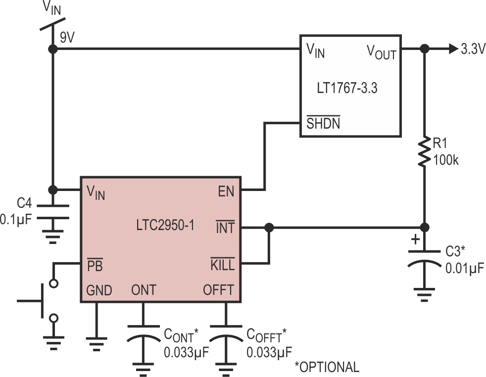

Operation Without μP
The LTC2950 is easily adapted for applications that do not use a μP or μC. Simply connect the \INT and \KILL pins to the output of the DC/DC converter. When the user presses the pushbutton to turn off system power, the interrupt output asserts the \KILL input, which then shuts off the converter. See Figure 4.
No μP Application.
Figure 4. No μP Application.
