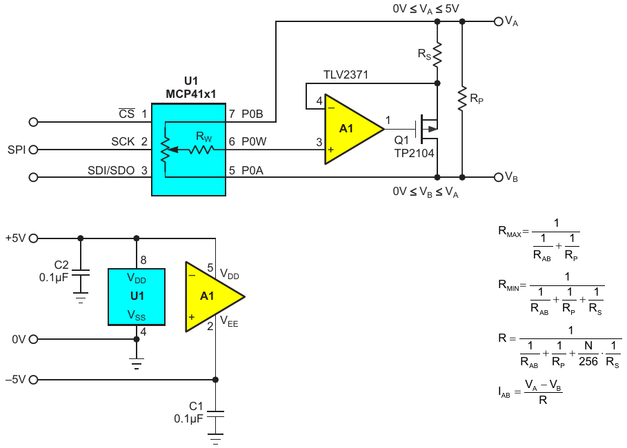

Figure 1. Classic variable resistance with the series connection of a manually adjusted rheostat-connected pot and a fixed resistor
Figure 2. Synthetic Dpot evades problems using FET shunt, precision fixed resistors, and op-amp
Figure 3. Synthetic rheostat design example where R
MAX
= 20k and R
MIN
= 1k
Figure 4. Performance of Figure 3's circuit with values shown, the linear relationship between N and I
AВ
conserves the Dpot's limited 8-bit resolution
Figure 5. Two buffer amps remove R
AB
from R
MAX
equation, allowing for an R
MAX
extending far into the megaohms
