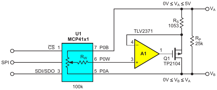

Synthesize precision Dpot resistances that aren't in the catalog

Figure 2. Synthetic Dpot evades problems using FET shunt, precision fixed resistors, and op-amp
Figure 3. Synthetic rheostat design example where R

= 20k and R
MIN
= 1k
Figure 4. Performance of Figure 3's circuit with values shown, the linear relationship between N and I
