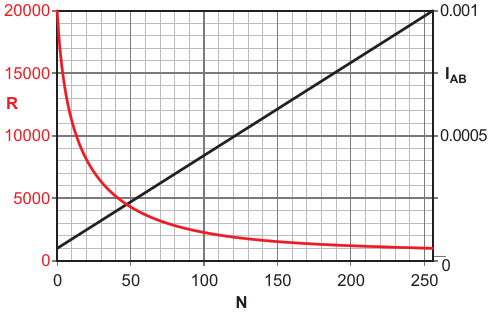

Performance of Figure 3's …
Performance of Figure 3's circuit with values shown, the linear relationship between N and I
AВ
conserves the Dpot's limited 8-bit resolution

Figure 4. Performance of Figure 3's circuit with values shown, the linear relationship between N and I
AВ
