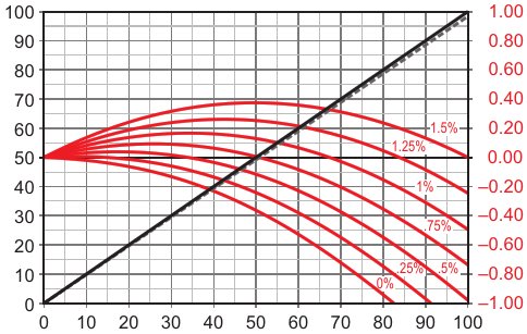

The Callendar-Van Dusen polynomial used here to predict that for any given temperature, an excitation current increment exists that will give an accurate readout, e.g., 0.5% for 33 °C, 1% for 67 °C, and 1.5% for 100 °C
AuthorsStephen Woodward
Main DocumentArticle «The power of practical positive feedback to perfect PRTDs»
DescriptionFigure 2
File Format / SizePDF / 12 Kb
