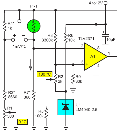

The 40 mV of positive feedback via R8 to reference U1 increases PRT excitation current with increasing temperature and thus linearizes the temperature reading, making the thermometer accurate to ±0.1 °C
AuthorsStephen Woodward
Main DocumentArticle «The power of practical positive feedback to perfect PRTDs»
DescriptionFigure 3
File Format / SizePDF / 16 Kb
