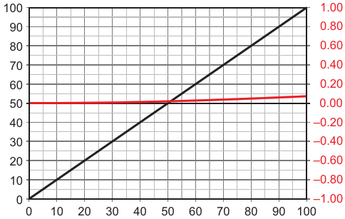

Figure 3. The 40 mV of positive feedback via R8 to reference U1 increases PRT excitation current with increasing temperature and thus linearizes the temperature reading, making the thermometer accurate to ±0.1 °C
Figure 4. Residual error with Figure 3's positive feedback
