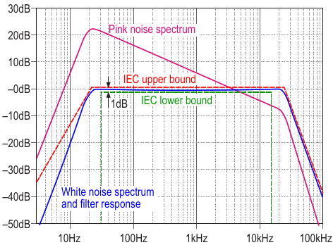

The calculated responses of the completed design, showing the mask for IEC 60268-1 limits and the peak errors of the filters

Figure 4. The calculated responses of the completed design, showing the mask for IEC 60268-1 limits and the peak errors of the filters
