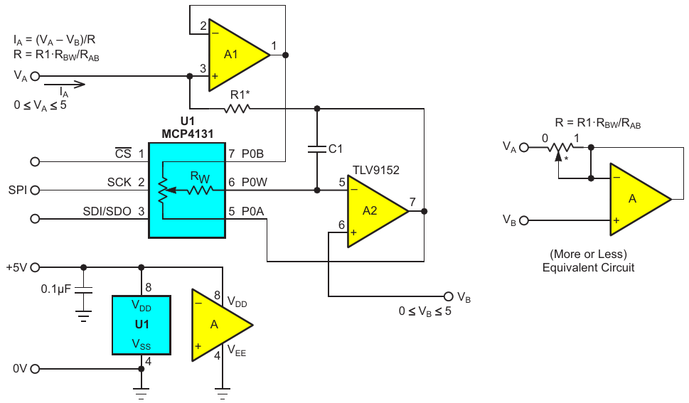

A precision digital rheostat …
A precision digital rheostat that synthesizes an accurate programmed resistance equal to reference resistor R1 linearly multiplied by U1's R
Figure 1. A precision digital rheostat that synthesizes an accurate programmed resistance equal to reference resistor R1 linearly multiplied by U1's R

Figure 2. Linear relationship between R and R

showing the circuit synthesizes an accurate programmed resistance equal to reference resistor R1 linearly multiplied by U1's R

Figure 3. Graphs for G
A2
(red) and R/R1 (black) versus R

on the x-axis. When the programmed value for R goes down, G
A2
must go up
Figure 4. Duplicate and cross-connect Figure 1's circuitry to get a two-terminal programmable resistance
