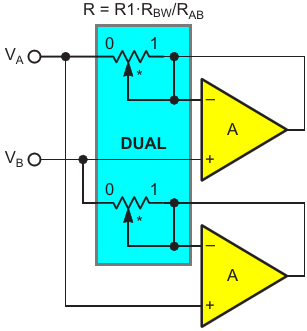

Figure 4. Duplicate and cross-connect Figure 1's circuitry to get a two-terminal programmable resistance
