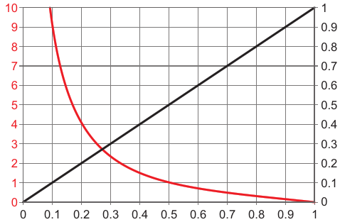

Graphs for G

Graphs for G
A2
(red) and R/R1 (black) versus R

on the x-axis. When the programmed value for R goes down, G
A2
must go up

Figure 3. Graphs for G
A2
BW
/R
AB
A2
must go up
