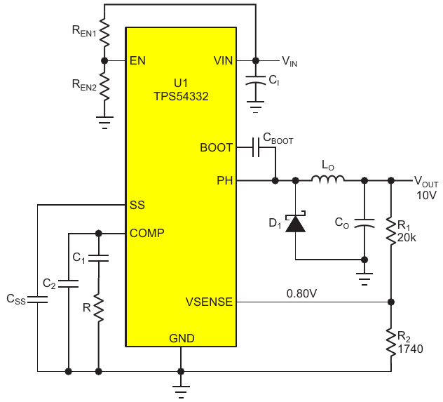

Three discretes suffice to interface PWM to switching regulators
Figure 1
12 Kb
Figure 1. A typical regulator output programming network with a basic two-resistor network for output voltage programming
Figure 2. Simple circuit for regulator programming with PWM where V
OUT
ranges from 0.8 V to 10 V as the duty factor (D) goes from 0 to 1
