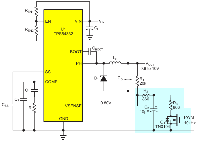

Simple circuit for regulator …
Simple circuit for regulator programming with PWM where V
OUT
ranges from 0.8 V to 10 V as the duty factor (D) goes from 0 to 1
Stephen Woodward
Three discretes suffice to interface PWM to switching regulators
Figure 2
15 Kb
Figure 1. A typical regulator output programming network with a basic two-resistor network for output voltage programming
Figure 2. Simple circuit for regulator programming with PWM where V
OUT
Figure 3. Graph showing V
OUT
versus the Figure 2 PWM D
Figure 4. D versus V
OUT
; the non-linearity necessitates a bit of software complexity to perform the conversion
