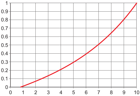

D versus V
OUT
; the …
D versus V
OUT
; the non-linearity necessitates a bit of software complexity to perform the conversion

Figure 4. D versus V
OUT
