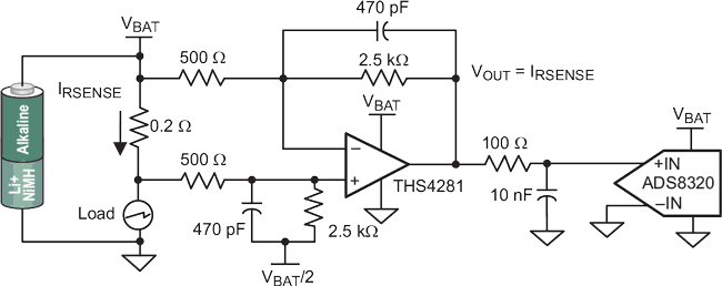

Another application for rail-to-rail input amplifiers is high-side battery monitoring in portable devices. TI’s THS4281 is a high-speed op amp that can be used for these use cases. It features rail-to-rail input as well as 90 MHz of bandwidth with only 0.75 mA of quiescent current, which enables designers to build fast and flexible systems with low power consumption. Figure 1 shows a typical high-side current-sensing circuit using the THS4281. The rail-to-rail input is very handy here because the input common mode in Figure 1 is typically within 1 V of the positive rail, which excludes most amplifiers without rail-to-rail inputs, including the OPA836.

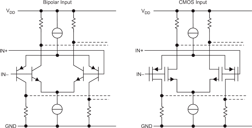

While rail-to-rail-input amplifiers are extremely versatile and user-friendly, there is an issue that needs careful attention. Most rail-to-rail input amplifiers use an input-stage topology similar to that shown in Figure 2. This circuit combines a main PNP/PMOS stage, which operates from below the negative rail to roughly 1.5 V from the positive rail and an “auxiliary” NPN/NMOS stage, which handles the last ~1.5 V of the ICMR to the positive rail. Consequently, there is usually a “switchover” or “crossover” region where the transition between the main and auxiliary stages takes place.

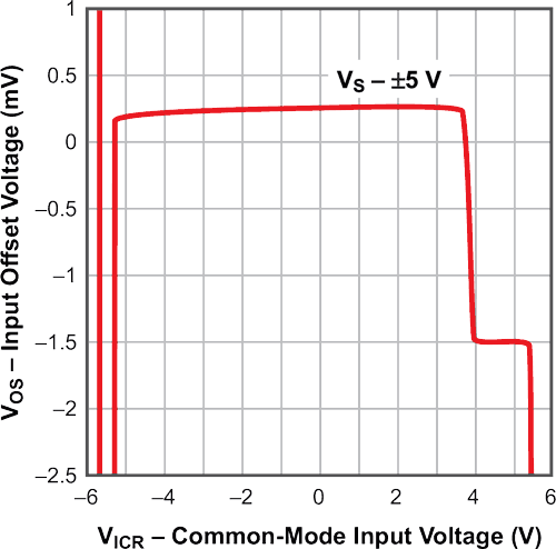

To identify this region, look at the offset voltage (VOS) versus the input common-mode voltage (VICR) plot, such as the one shown in Figure 3 for the THS4281. In this case, the VOS “jump” at VINCM from VS+ – 1.4 V to VS+ – 1 V marks the region where the switchover occurs. Sometimes in a precision application where the unity-gain measurements need to be accurate within 1mV, this kind of VOS jump is not desirable.
| Figure 3. | A plot of input common-mode voltage (VICR) versus offset voltage (VOS) for the THS4281. |
Integrated circuit designers have various techniques to reduce this crossover error, but unless you add an internal charge pump, the crossover error always exists. In most cases, this crossover region is a nuisance, rather than a showstopper. For example, in Figure 1, as long as VBAT stays below 12 V, the input common mode should remain above the crossover region. Similarly in an inverting or transimpedance amplifier circuit, you can still set the input common-mode voltage to any value within the supply rails, as long as you remain mindful of the switchover region. Also, since the input voltages in these op-amp circuits do not move, the switchover behavior is much less noticeable.
