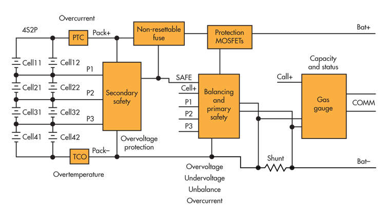

Other sources of waste heat include protection and gas-gauge circuits inside the battery itself. These heat sources include the positive temperature coefficient thermistor (PTC) and thermal cutoff fuse (TCO), electronically controlled fuse (usually a chemical self control protector), the primary protection MOSFETs, and the current measurement shunt for the gas gauge (Fig. 1). At high current, the resistance of the nickel strips used to interconnect the cells and circuit board traces also becomes significant.
| Fig. 1. | Heat sources inside the battery include the PTC and TCO, the electronically controlled fuse, the primary protection MOSFETs, and the current measurement shunt for the gas gauge. |
Most electronic elements in the current path are resistive in nature. The heat produced is proportional to the square of the current through the element (P = R·I2). When charge and discharge currents are low (e.g., under 1 A), small resistive elements like the on resistance of protection MOSFETs and current shunt resistance produce little heat. However, these heat sources become critical design challenges as the current increases. It’s not unusual for large Li-ion batteries to deliver discharge current of 10 A or more and have charge current specs in the 5-A range. At these current levels, even the smallest resistive element can produce significant heat and contribute to battery temperature rise over a several-hour charge or discharge cycle.

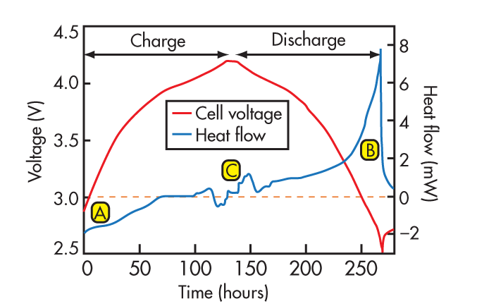

Almost completely ignored is the chemical reaction in the cell. The chemical reaction that takes place during the charging of a lithium-chemistry cell is endothermic, as it absorbs heat. Since there is no free lunch in thermodynamics, the discharge reaction is exothermic and produces heat. The Central Research Institute of Electric Power Industry (CRIEPI) conducted a classic study in 1995 that characterized these reactions in a calorimeter. Figure 2 was taken from a report on that research (see http://criepi.denken.or.jp/en/e_publication/a1996/96seika29.html).
| Fig. 2. | In Li-ion cells, the charge chemical reaction is endothermic (A), and the discharge is exothermic. Note that near the end of the discharge, the heat produced increases rapidly, indicating a rapid increase in cell impedance near the end of cell capacity. |
This plot shows a charge cycle followed by a discharge cycle of a single Li-ion cell and details the heat flow into and out of the cell during this process. The initial section of the plot, labeled “A,” shows the endothermic nature of the charge chemical reaction. The discharge section, labeled “B,” is obviously exothermic. But the surprise is that near the end of discharge, the heat produced increases rapidly, indicating a rapid increase in cell impedance near the end of cell capacity. (Note that constant current charge and discharge was used.)
The endothermic nature of the charge chemical reaction is weak compared to other heat sources. In every case we’ve studied at Micro Power, battery temperature increased during charge because the other heat sources overwhelm the weak endothermic chemical reaction inside the cell.
The strong exothermic nature of the discharge chemical reaction may cause a large increase in temperature rise near the end of discharge. This is compounded by the fact that many times, the load on a battery is constant-power in nature. As the battery voltage decreases near the end of its capacity, the current must increase to maintain constant power. This causes all the resistive elements in the battery circuit to produce more heat and can result in a large battery temperature increase.
