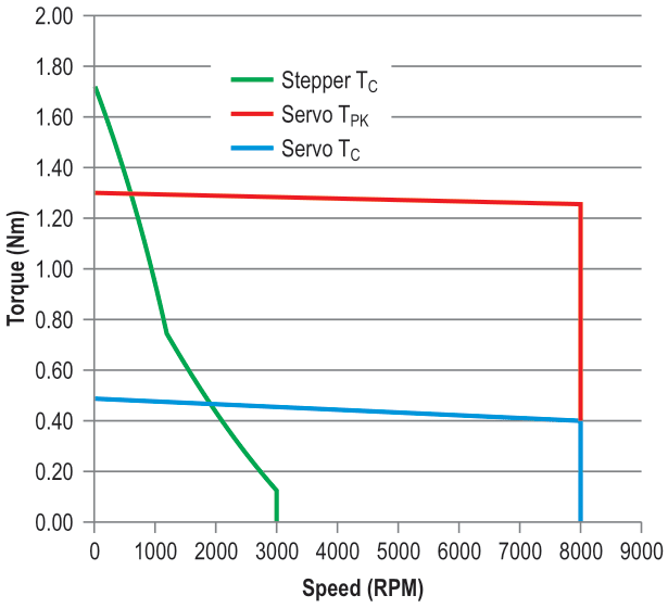

On the downside, stepper motors’ speeds are limited. They generally run well at 1,200 rpm or lower. And although they generate high torques at zero speed, torque falls off as speed increases. A motor that generates 100 oz-in at zero speed might only deliver 50 oz-in at 500 rpm and just 10 oz-in at 1,000 rpm (Figure 2).
In theory, adding a gearbox could increase torque, but then the stepper’s low speed would be a problem. Adding a 10:1 gear reducer to a 1,200-rpm stepper motor might boost the torque by an order of magnitude but it will also drop the speed to 120 rpm. If the motor is driving a ball-screw actuator or something similar, it probably will not deliver enough speed to satisfy the application’s needs.

In general, serve motors run significantly faster than steppers, with speeds on the order of several thousand rpm. This lets servo motors be used with gearboxes to deliver much higher torque at useful speeds. They also deliver more consistent torque across the motor’s speed range of the motor.

Servo motors have the speed and torque to deliver higher accelerations than stepper motors. They also deliver more accurate positioning, thanks to closed-loop control.
