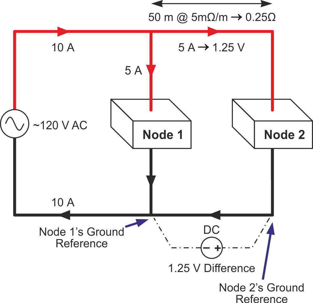

Another frequent cause of common-mode voltage is the difference in ground potential that can occur between different nodes on the network. Substantial ground potential differences are common in industrial networks because electrical installations can often reach tens if not hundreds of meters. Figure 1 shows a simple two-node network with 50 meters of cabling between the two nodes, each of which draws 5 amps of current. Even with just 5 mΩ of resistance per meter on standard 12 AWG cabling, this results in a 1.25 V ground potential difference between the two nodes.

Figure 1. Effects of wire resistance on long electrical installations.

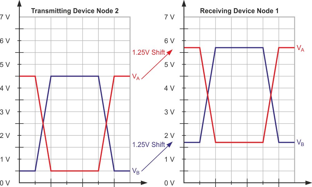

This difference in ground potential causes the receiving nodes on the network to “see” the voltages at their bus input terminals at a different voltage potential. Taking the example in Figure 1 and assuming an RS-485 network where Node 2 transmitted a bit stream, Node 1 would receive that bit stream with a 1.25 V higher DC offset (Figure 2).

It is easy to see how this ground potential difference could become even larger when additional loads are added to the network and the total length of cabling expands. Current from each additional load is superimposed on top of the existing current in the cable, and the effects of the cable resistance become proportionately worse. Imagine an elevator in a 50-story building with a node on every floor and five meters of cabling per floor. The ground potential difference could easily reach tens of volts, exceeding the common-mode range of most transceivers (for example, –7 to +12 V).
