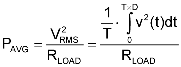

Power delivered by unfiltered PWM
The expression for the average power in the load when driven by the circuit of Figure 1b is:
			(2) |
where:
PAVG is the power dissipated by the load in watts,
VRMS is the RMS voltage across the load,
RLOAD is the load resistance in ohms,
T is the PWM period in seconds,
D is the duty cycle for the PWM (0 ≤ D ≤ 1),
v(t) is the instantaneous voltage across the load.
Equation 2 represents power delivered to the load. Fortunately, the integral in Equation 2 becomes a simple expression by realizing that v(t) is equal to the PWM drive voltage (VCC) during the ON part of the PWM cycle, and the period (T) cancels in the math. The resulting equation for the average power in the load is:
			(3) |
Equation 3 represents power delivered to the load after simplifying.
