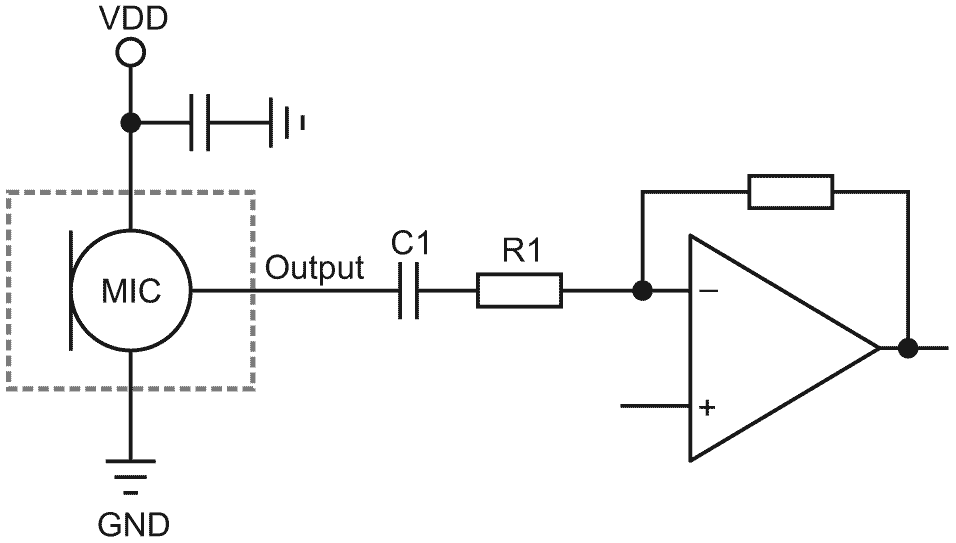

MEMS microphones that come with analog outputs offer a simple interface to the host circuit, as depicted in Figure 1 below. It is worth noting that the internal amplifier of the microphone drives the analog output signal, which is already at a reasonable signal level and features a relatively low output impedance.
| Figure 1. | Analog MEMS microphone connected to an external amplifier. |
To avoid having to match the dc input voltage of the host circuit with the dc output voltage of the MEMS microphone, a dc blocking capacitor (C1) is utilized. The combination of C1 and R1 forms a pole frequency that must be set low enough to ensure that the desired audio frequency signals are transmitted to the host circuit with an acceptable level of attenuation; i.e., for a minimum audio frequency range of 20 Hz:

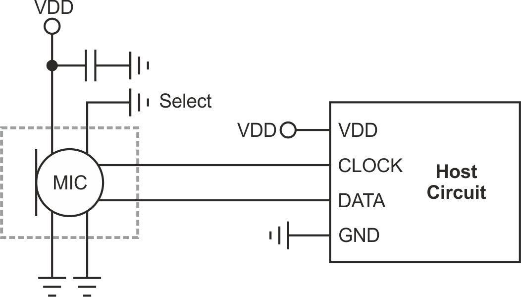

Figure 2 illustrates how a single digital PDM microphone can be connected to a host circuit. The "Select" pin in the figure can be connected to either VDD or Gnd to determine whether the data is asserted on the rising or falling edge of the clock signal.
| Figure 2. | Single connection of a digital PDM MEMS microphone. |

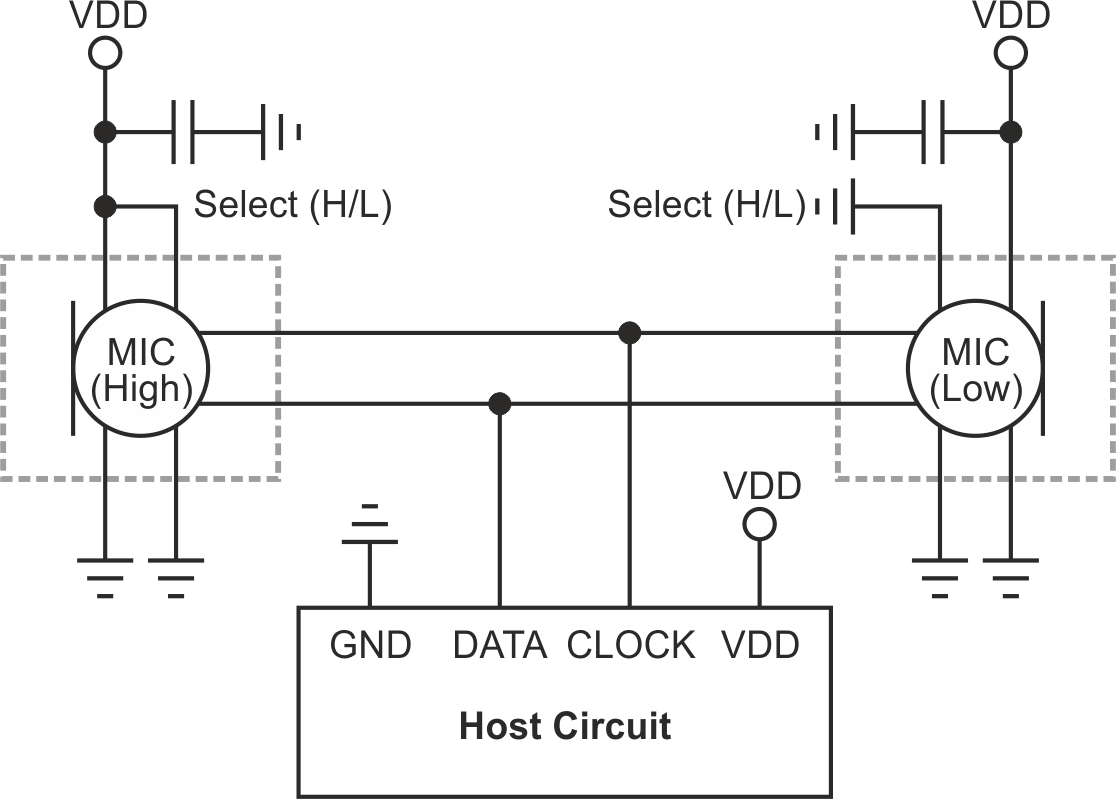

Figure 3 depicts how two digital PDM MEMS microphones can be connected to the host circuit using shared clock and data lines. This configuration is often used when implementing stereo microphones.
| Figure 3. | Connecting two digital PDM MEMS microphones using the clock and data lines. |
