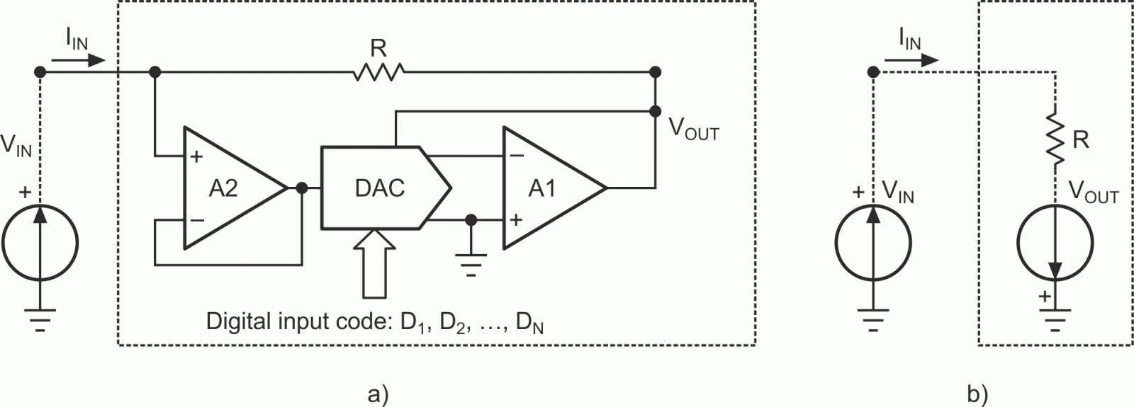

The circuit in Figure 2a is a programmable amplifier whose output voltage is proportional to the digital input code of the DAC (digital-to-analog converter). The DAC and amplifier A1 form a programmable inverting amplifier. The circuit actually functions as a divider because its gain, or transfer function, is less than 1. The difference between voltages VIN and VOUT forces a current through resistor R. You can use that value to calculate REQ in the bridge circuit. Figure 2b shows the equivalent circuit for the programmable amplifier.
| Figure 2. | a) Programming the DAC’s output voltage changes REQ, which can balance a bridge circuit. b) Equivalent circuit. |
Using a microcontroller or a PC, you can adjust REQ by programming the DAC’s output voltage and then measuring the voltage across the bridge and adjusting REQ until the bridge comes into balance. Because A1 is an inverting amplifier, the circuit’s gain is
where the D terms represent the values of the DAC’s bits. If you use a 12-bit DAC, then N = 12.
To calculate REQ, you need to know the current in the circuit. If you assume that buffer amplifier A2 has infinite input impedance and zero bias current, then you can calculate IIN, which is
and
