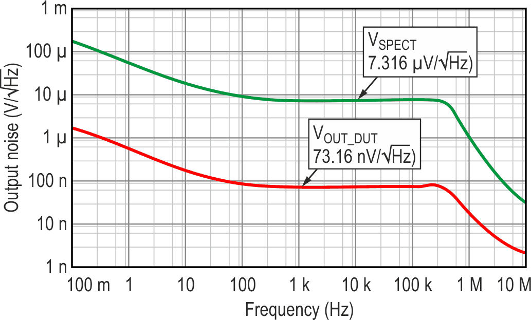

Add noise measurements to your benchtop tools
Figure 2. The post-amp circuit elevates the noise floor for the device under test (DUT).
If you short the inputs of the DUT to ground, what appears at the input of the
post-amp circuit is the noise density of the DUT. (The gain of the noise amplifier
is set by resistors RG and RF – in this case, 100.)
If you ground the input of the test fixture (the input signal is zero), your output in principle will be the noise of the device under test – in this case, less than 100 nV/√Hz from 100 Hz to 500 kHz. The spectral density of the output noise (most of it) falls below 100 Hz.
