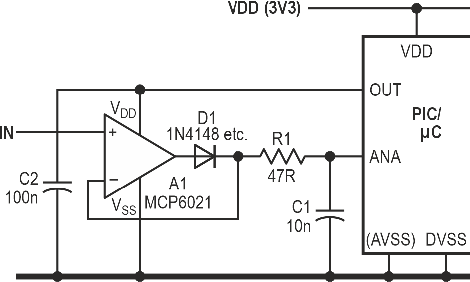

Figure 1 shows the basics. We may want to add some complications later.
The basic peak-hold circuit. The PIC pin labelled ANA samples the voltage on C1 and then resets it to ground, ready for the next sample.
Figure 1. The basic peak-hold circuit. The PIC pin labelled ANA samples the voltage
A1 and D1 form an “active diode”, which rapidly charges C1 to the peak input voltage through R1 whenever A1’s non-inverting input is higher than the diode’s output voltage and hence that on the inverting input. C1 holds its charge as it has no discharge path – leakages excepted – until the PIC needs to sample it, when the ADC is assigned to the relevant input pin (marked as ANA) which starts the acquisition period, during which C1’s charge is shared with the PIC’s internal CHOLD. Once this is done, the conversion can be started, which also immediately disconnects that pin from the ADC, allowing it to be changed from analog input to digital output (active low) to discharge C1, resetting the circuit ready for the next cycle. Thus, a single processor pin performs two functions. Listing 1 shows typical code for the essentials.

Now that we’ve got it working, it’s time to point out its shortcomings and suggest some workarounds.
The voltage across C1 can never be higher than a diode-drop below A1’s VDD, which limits the effective measurement range. (Although a Schottky diode with its lower forward voltage could be used for D1, the higher reverse leakage will compromise accuracy.) If the input must cover the full span, it’s easiest to pot it down first, and either accept a slightly limited resolution on measurements or use a lower reference voltage (2.55 V might be ideal) for the DAC. A1’s VDD can be boosted – see later on – to allow a full positive swing. Similarly, its VSS could be pushed negative if readings needed to be taken very close to ground. Again: see later.
Any input offset in A1 will affect precision. 1 LSB is about 13 mV when using 8 bits with a 3.3 V reference, or ~800 µV with 12 bits, so the allowable offset is half that. (The offset is quoted as being 500 µV at most.)
Note that while C1’s voltage will be measured with respect to the PIC’s AVSS – or perhaps its VREF- pin – it will be discharged to DVSS. (The lower pin-count devices combine AVSS and DVSS on a single ground pin.) Be cautious of any relative offset between them if accuracy is paramount at low input levels. Microcontrollers are often put to sleep during analog measurements to minimize such errors, which can vary according to how hard the device is working.
A more subtle source of errors is inherent in the ADC’s operation. Internally, it uses a small capacitor (CHOLD), anywhere from 10 pF to 120 pF depending on the device’s vintage, to hold the input for processing. The charge on the external capacitor C1 is shared with the internal one during the acquisition time, so unless the ADC is actually connected to the pin when the input pulse arrives, it will read low, scaled by
With C1 = 10 nF and if the DAC’s CHOLD  = 10 pF, as in the more modern PICs, the error will be ~1 LSB for a 10-bit result, but negligible for 8 bits; lower values of C1 will lead to greater errors.
If that input pulse is shorter than the reset period and arrives while the pin is being held low, it will be attenuated and effectively lost. (And make sure that A1’s decoupling cap can source the inevitable power transient.) Adding an extra MOSFET (extra GPIO pin required, as shown in Figure 2, below) allows ‘instant’ resetting (or around a thousand times faster, probably within a single instruction cycle), and to a genuine ground rather than the PIC’s internal one. (The ADC’s pin would then be left in analog mode.) A cure in ultra-critical situations might be to duplicate the hold circuitry on another pin and sample each channel alternately, selecting the higher reading in code.
In my original application, which was measuring the strength of RF signal bursts, none of these points was a problem, as the input was always between 0.2 and 2.5 V and lasted for hundreds of microseconds, while the output was scaled to read from 0 to 9.
Despite these reservations, this open-loop approach can be faster than the standard configuration which wraps an op-amp round the capacitor. Because C1 is driven directly, the rise-time of the input pulse can now be as fast as you like. A1’s output may overshoot momentarily, but the glitch will be absorbed by the longer time-constant of R1C1.
For accuracy, R1 should be chosen so that the op-amp’s output drive never exceeds its current-limit value, as that would break the feedback loop, resulting in overshoot and a falsely high reading. Also, for clean operation, time-constant R1C1 should be no less than A1’s rail-to-rail slewing time. The 10n + 47R (470 ns is about the same as the measured slew) allowed for accurate measurements of 2.5 V pulses as short as ~3 µs. Experiments showed that R1 could be reduced to 27R, giving a –10% error for 1 µs/2.5 V input pulses.
