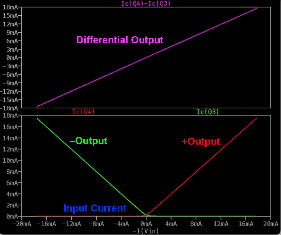

On large negative inputs, all the input current is sourced by Q3 as its emitter voltage drops and Q1 becomes cutoff, with Q3’s collector sinking the negative output (Figure 2). Note that for large positive inputs, the output currents are “directed” to either Q4 (+) or Q3 (–) and unlimited with ideal devices.
LTspice simulation of differential output in response to large negative signal inputs.

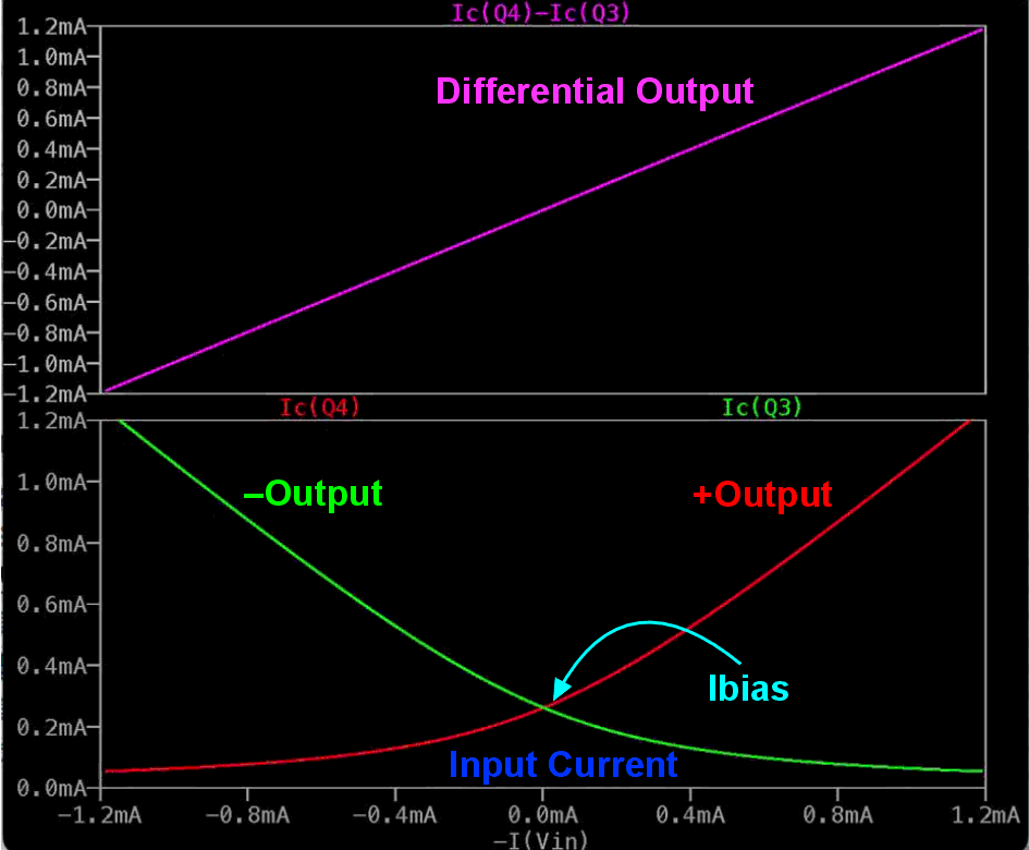

As shown in Figure 3, with smaller inputs, the circuit acts like a small signal Class A type as all the transistors operate with an IBIAS collector current. So, with zero input current, both Q1 and Q3 conduct IBIAS, as does Q2 and Q4 and the circuit acts with a differential output.
LTspice simulation of differential output in response to small negative input current.
Figure 3. LTspice simulation of differential output in response to small

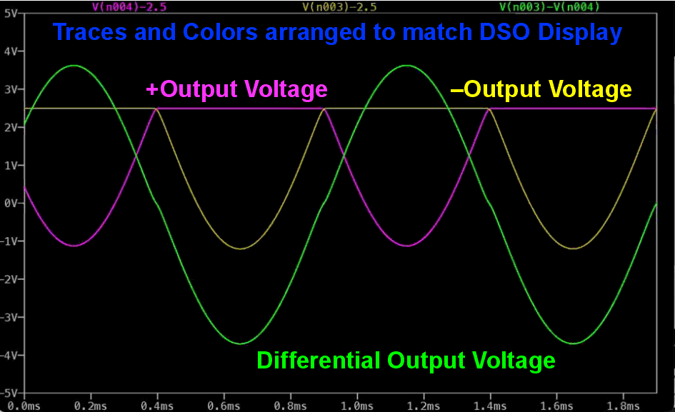

Actual results of Figure 1 schematic shown on a DSO with a sine-wave input of 2 Vpp @ 1 KHz.
Figure 4. Actual results of Figure 1 schematic shown on a DSO with a sine-wave input of 2 Vpp @ 1 KHz.
Figure 4 shows actual results from the circuit in Figure 1, shown on a DSO with a sine-wave input of 2 Vpp@1 kHz. Figure 5 shows the LTspice simulation results of Figure 1. Note the LTspice plots were set up with color and display offset bias to match DSO display for comparisons.

Also note the slight “cross over distortion” shown in both the DSO and LTspice results – common to conventional Class A/B stages. This can be improved with a higher IBIAS at the expense of higher amplifier dissipation.

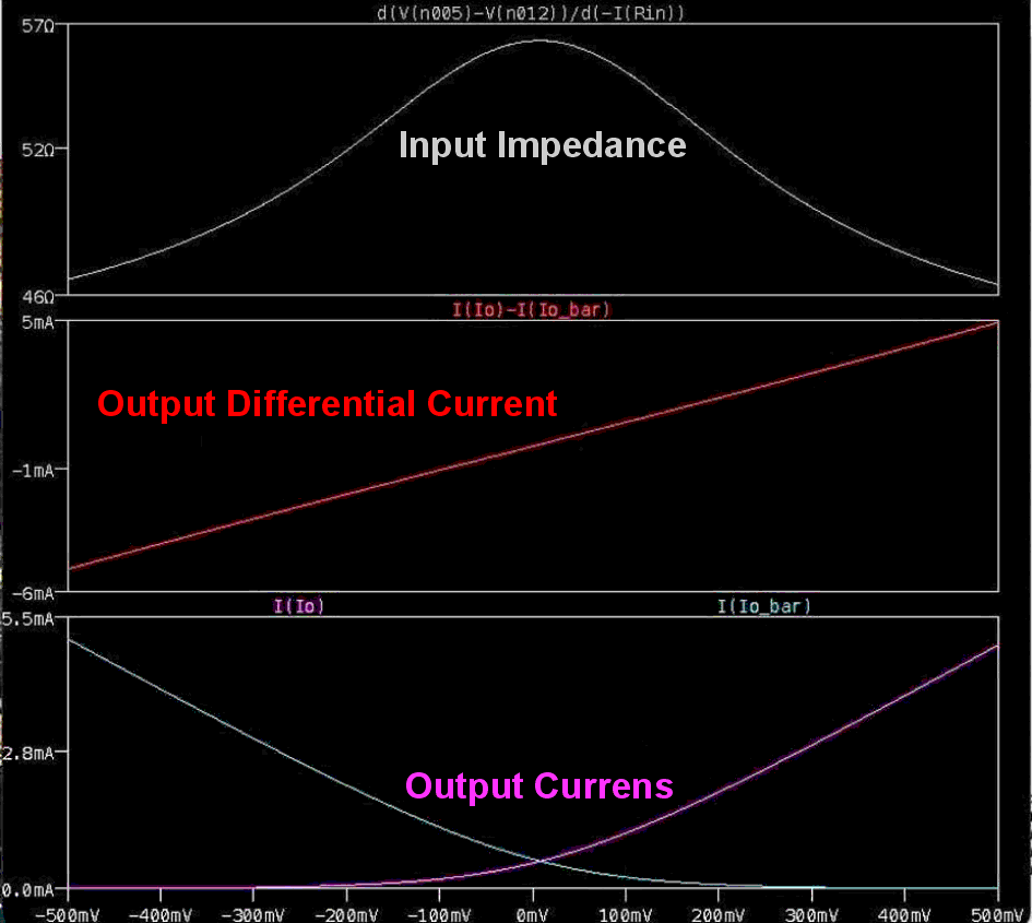

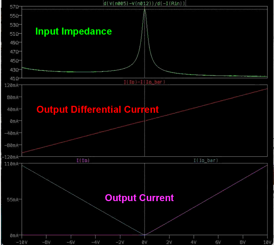

As shown in Figure 7 and Figure 8, the LTspice input impedance results were created by taking the derivative of input voltage with respect to input current as the input is swept across a large positive and negative range.
Small signal input impedance results and output differential current.
Figure .7 Small signal input impedance results and output differential current.
Large signal ±10 V peak input impedance results and output differential current.
Figure 8. Large signal ±10 V peak input impedance results and output
