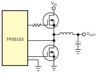

This classic buck regulator suffers from excessive negative phase-node voltage

Circuit reduces negative-voltage stresses on control IC
Figure 1. This classic buck regulator suffers from excessive negative phase-node voltage
Figure 3. Moving one resistor and adding a small Schottky diode minimizes the phase-node voltage
