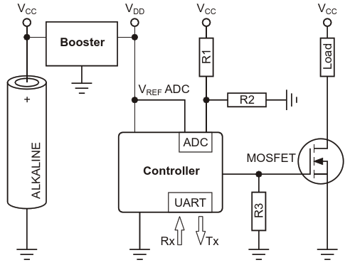

This simplified schematic shows …
This simplified schematic shows the general design of an EDR test implementation

Figure 1. Comparing the response to a temporary load pulse by batteries at various charge states demonstrates their differences in EDR
Figure 2. This simplified schematic shows the general design of an EDR test implementation
Figure 4. The EDR test code turns on the load, samples for half the test time, then turns off the load and completes the sampling period
