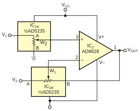

A low-cost difference amplifier uses digital potentiometers to set the gain

Figure 1. A low-cost difference amplifier uses digital potentiometers to set the gain
Figure 2. A plot for common-mode rejection ratio versus frequency for the circuit in Figure 1 yields a figure of 98 dB
