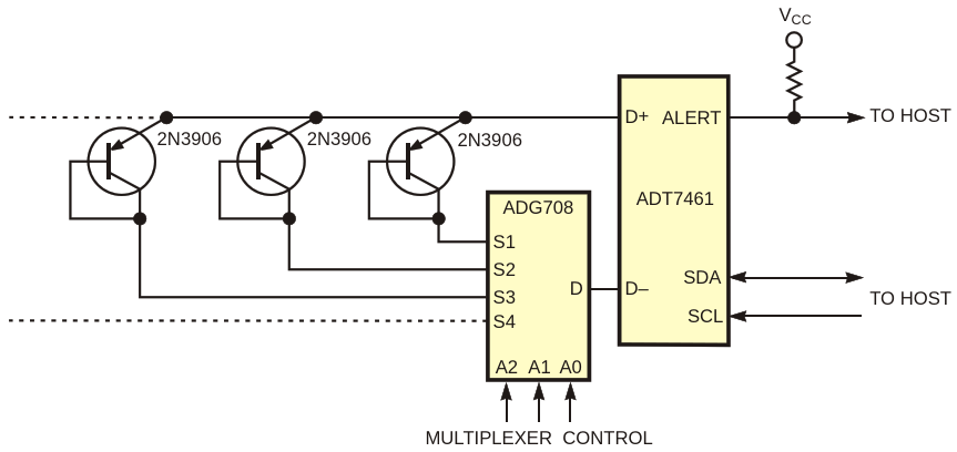

This system measures the temperature of three remote thermal zones

Temperature monitor measures three thermal zones
Figure 1. This system measures the temperature of three remote thermal zones
Figure 2. The system in Figure 1 measures ambient (address 000), cold (address 001), and hot (address 010) temperatures
