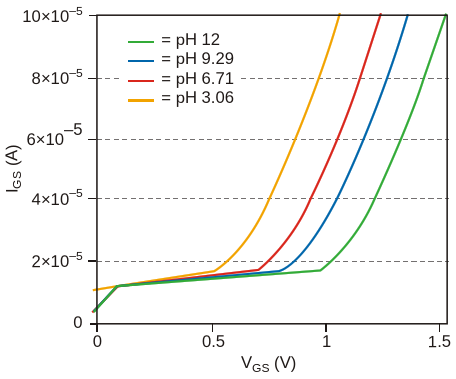

The gate-source voltage of an ISFET shifts with the degree of acidity

Figure 3. The gate-source voltage of an ISFET shifts with the degree of acidity
