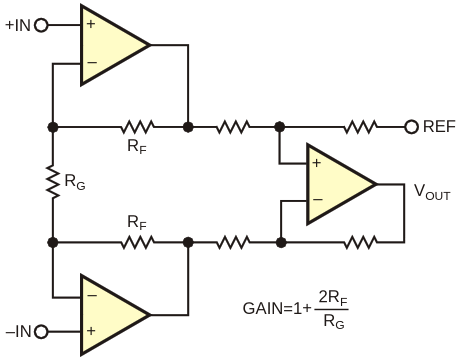

The classic three-op-amp instrumentation amplifier does not provide differential outputs

Figure 1. The classic three-op-amp instrumentation amplifier does not provide differential outputs
Figure 2. The four-op-amp instrumentation amplifier (a) provides differential outputs but requires many matched resistors. A differential-output op amp (b) reduces the IC count in Figure 2a to three
