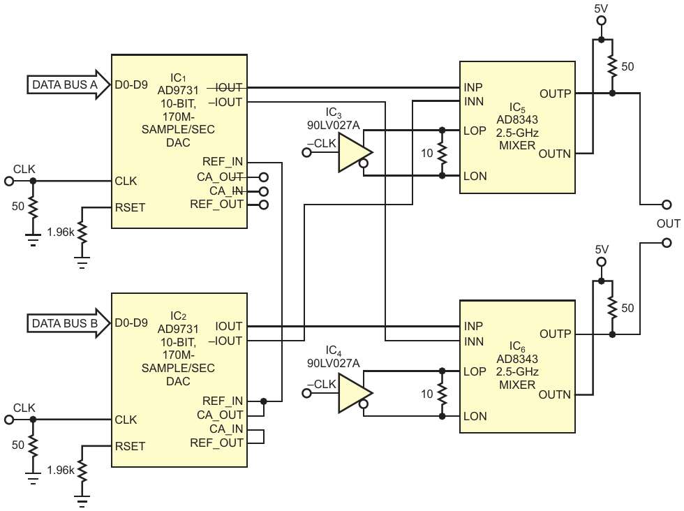

"Ping-ponging" the outputs of two DACs effectively doubles the throughput rate
Randall Carver
Double DAC rate by using mixers as switches
Figure 2
16 Kb
Figure 1. You can use cross-coupled differential transistor pairs as current-mode switches
Figure 2. "Ping-ponging" the outputs of two DACs effectively doubles the throughput rate
