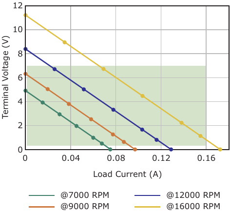

Running brushed DC motors as generators

Figure 4. Working range of Portescap 17 DCT motor
