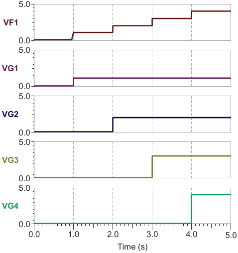

Simulation plot of the output of the 4-channel priority amplifier

Figure 1. Input Priority Amplifier provides an output from the most positive of four inputs. This circuit responds to positive inputs, but by reversing the diodes and re-configuring the power supplies, it can respond to negative inputs
Figure 2. Simulation plot of the output of the 4-channel priority amplifier
