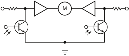

This circuit is the same as that in Figure 3, and it works with phototransistors without modification

Limit switches control dc-motor H bridge
Figure 1. This circuit works by inhibiting movement in one direction but allowing movement in the other direction when the motor retracts from its end position
Figure 2. This circuit shortens one input of the H bridge to ground so that movement is possible only in the other direction by turning on the other input
Figure 3. This circuit interrupts the connection to the driving circuit of one input and sets the input to low using a pulldown resistor
Figure 4. This circuit is the same as that in Figure 3, and it works with phototransistors without modification
Figure 5. This circuit is the same as that in Figure 4; the value of the resistors depends on the parts you use
