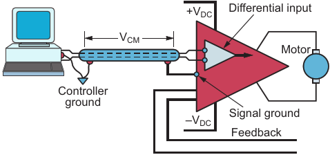

Servoamps with differential inputs and a high degree of common mode rejection are immune to differences in ground voltages

Figure 1. This circuit uses a servoamp drive that can make motions or operation erratic by exposing the servoamp to common-mode voltage interference, V
CM
Figure 2. Servoamps with differential inputs and a high degree of common mode rejection are immune to differences in ground voltages
