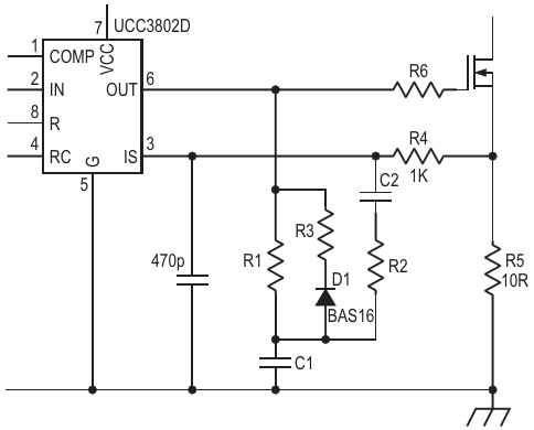

Slope compensation that works …
Slope compensation that works for any controller
Francesc Casanellas
New slope compensation method stabilizes switchers
Figure 6
12 Kb
Figure 1. Stable operation
Figure 2. Unstable operation
Figure 3. Ramping current limit
Figure 4. Ramping current limit with the same slope as the inductive down current
Figure 5. Typical slope compensation
Figure 6. Slope compensation that works for any controller
