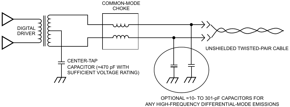

A center-tap capacitor connected …
A center-tap capacitor connected to earth ground implements a common-mode current trap and reduces RF emissions. A common-mode choke in addition to this center-tap trap results in a common-mode killer
Glen Chenier
Emissions killers trap common-mode currents
Figure 1
