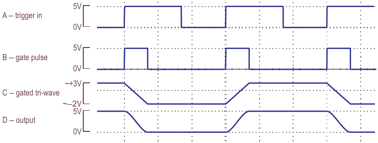

Some waveforms from the circuit in Figure 1

Figure 1. Extra logic added to the original circuit now gives half a cosine on each trigger pulse, with alternating polarities, generating a square wave with smoothed edges
Figure 2. Some waveforms from the circuit in Figure 1

Figure 5. Waveforms after adding the mods shown in Figure 4
Figure 6. Comparison of the target curve with part of the trace D in Figure 5
