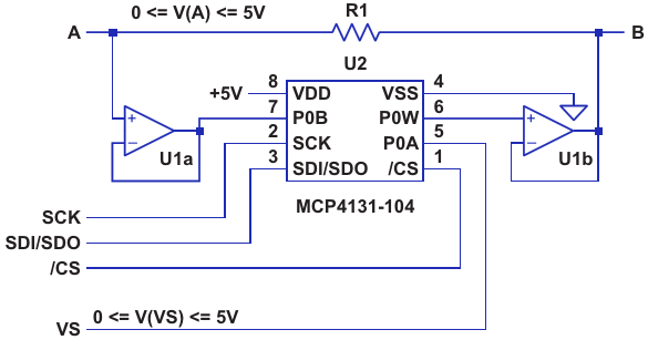

A basic programmable rheostat …
A basic programmable rheostat leveraging the same digital pot used in other solutions
Christopher Paul
A class of programmable rheostats
Figure 1
11 Kb
Figure 1. A basic programmable rheostat leveraging the same digital pot used in other solutions
Figure 2. Enhanced programmable rheostat that mitigates the uncertainties problems of the basic programmable rheostat by reducing the required maximum value of "num"
Figure 3. LTspice can be used to determine op-amp requirements for an AC signal application
