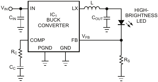

A generic buck converter, …
A generic buck converter, IC
1
, provides constant-current drive for a high- brightness LED

LED drivers minimize power dissipation
Figure 1
10 Kb
Figure 1. A generic buck converter, IC
1
