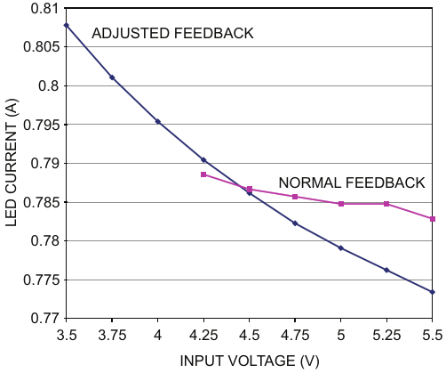

This graph shows LED current as a function of input voltage at full load for the circuit of Figure 3

LED drivers minimize power dissipation

Figure 3. Adjusting the feedback signal improves the efficiency in this buck-converter driver for high-brightness LEDs
Figure 4. This graph shows LED current as a function of input voltage at half- load for the circuit of Figure 3
Figure 5. This graph shows LED current as a function of input voltage at full load for the circuit of Figure 3
Figure 6. A comparison of a normal-feedback circuit (Figure 1) and an adjusted- feedback circuit (Figure 3) shows significant improvements in overall efficiency at half-loads and at full loads
